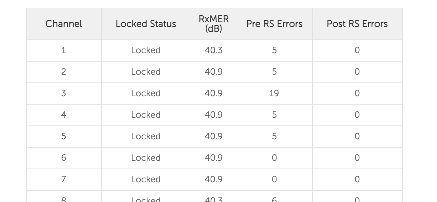

Unfortunately i have no device with RJ45 port. So i cant connect via cable.
I also read few topics and find out that it might be an issue with splitter. So i changed it to another one (from previous tenant), plus i removed second out TV cable.
After that i saw the number of Power (dBmV) increased from previous range  [-0.5, 2.5] to (you may see in the picture). On top of that, values Pre RS Errors, Po
st RS Errors decreased from hundreds to around zero (also may see on the picture).

Are your computers still connected to the WiFi network when you experience problems? What lights do you see on your modem?

Can you give us a little more information? For example, do you also experience it with a wired connection directly connected to the modem? Can you share a photo of the main connection and how the modem is connected to it? And you can share the up and downstream values ​​of the modem with us.

I`ll keep an eye on connection issues during the weekend. If i still experiencing issue i let you know in this thread. Otherwise i`ll close it.

UPD: During weekend no Wifi connection drop. No issue with internet.
Topic can be marked as solved \ closed
