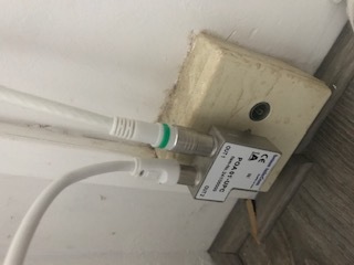

And can you put a picture here of the first place where Ziggo enters your house with possible splitters and amplifiers?

I just unplugged the cables and plugged them in again. I live in an old apartment block so I'm not sure where the cables go in on the outside.
