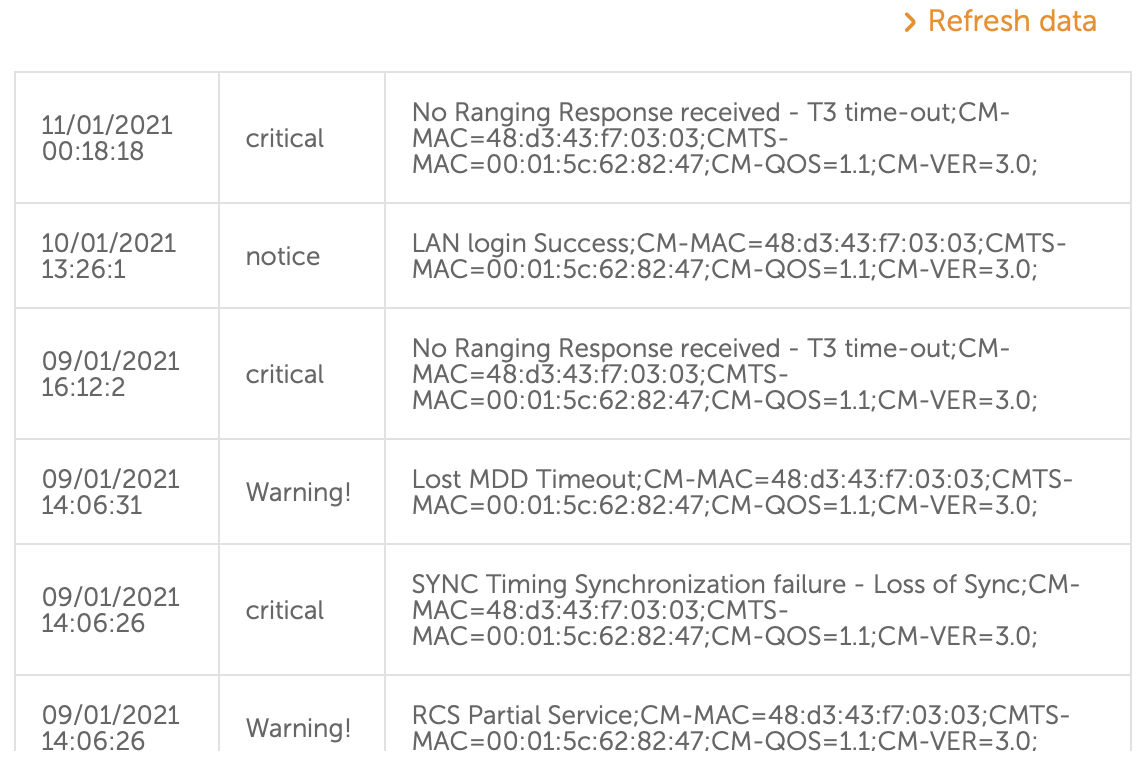

Wat zijn T3 Timeouts? Het internet valt overigens vaker weg dan hier geteld is. En dat na een reset van het modem minder dan 24 uur geleden.
En weet iemand wat deze foutmeldingen inhouden?
Monteur net geweest volgens hem is het ruis….. Gaat weer een ander naar kijken binnen 3 dagen! We wachten wel weer af.

Time | Priority | Description |
12/01/2021 12:41:31 | Warning! | Lost MDD Timeout;CM-MAC=48:d3:43:f7:03:03;CMTS-MAC=00:01:5c:62:82:47;CM-QOS=1.1;CM-VER=3.0; |
12/01/2021 12:41:26 | critical | SYNC Timing Synchronization failure - Loss of Sync;CM-MAC=48:d3:43:f7:03:03;CMTS-MAC=00:01:5c:62:82:47;CM-QOS=1.1;CM-VER=3.0; |
12/01/2021 12:41:26 | Warning! | RCS Partial Service;CM-MAC=48:d3:43:f7:03:03;CMTS-MAC=00:01:5c:62:82:47;CM-QOS=1.1;CM-VER=3.0; |
11/01/2021 21:45:21 | Warning! | Lost MDD Timeout;CM-MAC=48:d3:43:f7:03:03;CMTS-MAC=00:01:5c:62:82:47;CM-QOS=1.1;CM-VER=3.0; |
11/01/2021 21:45:15 | critical | SYNC Timing Synchronization failure - Loss of Sync;CM-MAC=48:d3:43:f7:03:03;CMTS-MAC=00:01:5c:62:82:47;CM-QOS=1.1;CM-VER=3.0; |
11/01/2021 21:45:15 | Warning! | RCS Partial Service;CM-MAC=48:d3:43:f7:03:03;CMTS-MAC=00:01:5c:62:82:47;CM-QOS=1.1;CM-VER=3.0; |
11/01/2021 21:45:14 | Warning! | RCS Partial Service;CM-MAC=48:d3:43:f7:03:03;CMTS-MAC=00:01:5c:62:82:47;CM-QOS=1.1;CM-VER=3.0; |
11/01/2021 21:45:10 | Warning! | Lost MDD Timeout;CM-MAC=48:d3:43:f7:03:03;CMTS-MAC=00:01:5c:62:82:47;CM-QOS=1.1;CM-VER=3.0; |
11/01/2021 21:45:5 | critical | SYNC Timing Synchronization failure - Loss of Sync;CM-MAC=48:d3:43:f7:03:03;CMTS-MAC=00:01:5c:62:82:47;CM-QOS=1.1;CM-VER=3.0; |
11/01/2021 21:45:5 | Warning! | RCS Partial Service;CM-MAC=48:d3:43:f7:03:03;CMTS-MAC=00:01:5c:62:82:47;CM-QOS=1.1;CM-VER=3.0; |
11/01/2021 21:45:4 | Warning! | RCS Partial Service;CM-MAC=48:d3:43:f7:03:03;CMTS-MAC=00:01:5c:62:82:47;CM-QOS=1.1;CM-VER=3.0; |
11/01/2021 15:23:54 | critical | No Ranging Response received - T3 time-out;CM-MAC=48:d3:43:f7:03:03;CMTS-MAC=00:01:5c:62:82:47;CM-QOS=1.1;CM-VER=3.0; |
11/01/2021 13:18:27 | notice | LAN login Success;CM-MAC=48:d3:43:f7:03:03;CMTS-MAC=00:01:5c:62:82:47;CM-QOS=1.1;CM-VER=3.0; |
11/01/2021 00:18:18 | critical | No Ranging Response received - T3 time-out;CM-MAC=48:d3:43:f7:03:03;CMTS-MAC=00:01:5c:62:82:47;CM-QOS=1.1;CM-VER=3.0; |

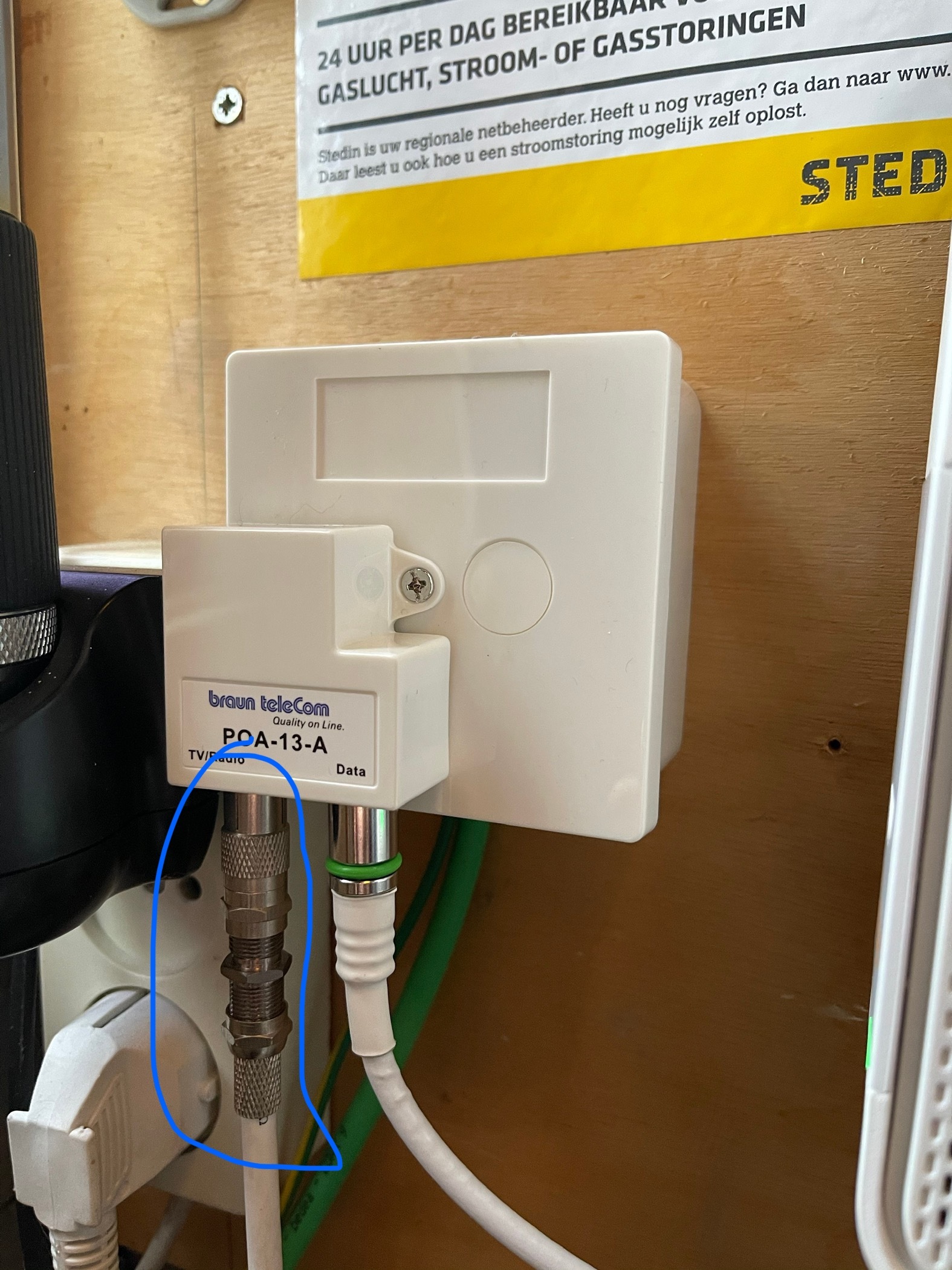

waar gaat die kabel naar toe die met blauw omcirkeld is ? kun je die connector eens vervangen voor een https://www.allekabels.nl/hirschmann-artikelen/257/3784310/hirschmann-antenne-stekker.html?gclid=EAI... zo dat die rechtstreeks op het aop kan
